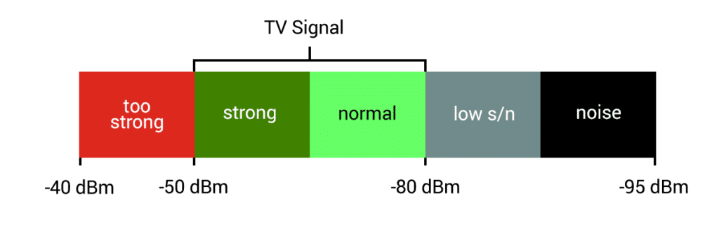

Digital TV tuners (like those in your TV and in your Tablo DVR) will generally process signals from about -50 dBm (strong) to about -80 dBm (weak).
Signal strength requirements for digital TV tuners
If your available channel signal falls within the green portion of the graph above, your Tablo DVR should be able to receive, stream and record the channel. Since digital signals are either ON or OFF, Tablo’s channel scan process may not discover a channel during a channel scan if it’s outside of, or bordering on this range.

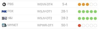

Signal Strength as Reported by Your Tablo DVR Channel Scan
When performing a channel scan within the settings screen of the Tablo app, Tablo’s tuner will connect with your antenna and do a quick scan of the channels it is receiving.
Tablo reports signal strength at the time of the scan with a series of five dots which represent an overall ‘grade’ for the signal.
Tablo Signal Strength Indicator
(Note – Since signal strength is not reported dynamically, if you’ve switched antennas, moved your antenna or are setting up your Tablo in a new location, you should perform a fresh channel scan.)
The signal strength displayed within the Tablo app is based on calculations of two criteria:
1. Bit Error Rate (BERR) – Error rates in the incoming video broadcast which can be mitigated to a certain extent with built-in error correction.
2. Packet Error Rate (PERR) – Error rates in video packets delivered through the Tablo which will rise as the level of errors in the broadcast video go beyond the automatic error correction ability.
Channels represented by five green dots have no or very few bit errors (BERR) which means no packet errors (PERR). The video and audio will be pristine, easily streamed and recorded.
Channels represented by three orange dots show some bit and/or packet errors which will result in video glitches and potentially buffering and recording errors.
Channels represented by one red dot have a bit and packet error rate which will make the video unwatchable and will result in extreme buffering and is unlikely to generate any complete recordings.
A channel error rate is higher than 50% the video will be unplayable and the channel will not be returned in the Tablo App channel scan results.

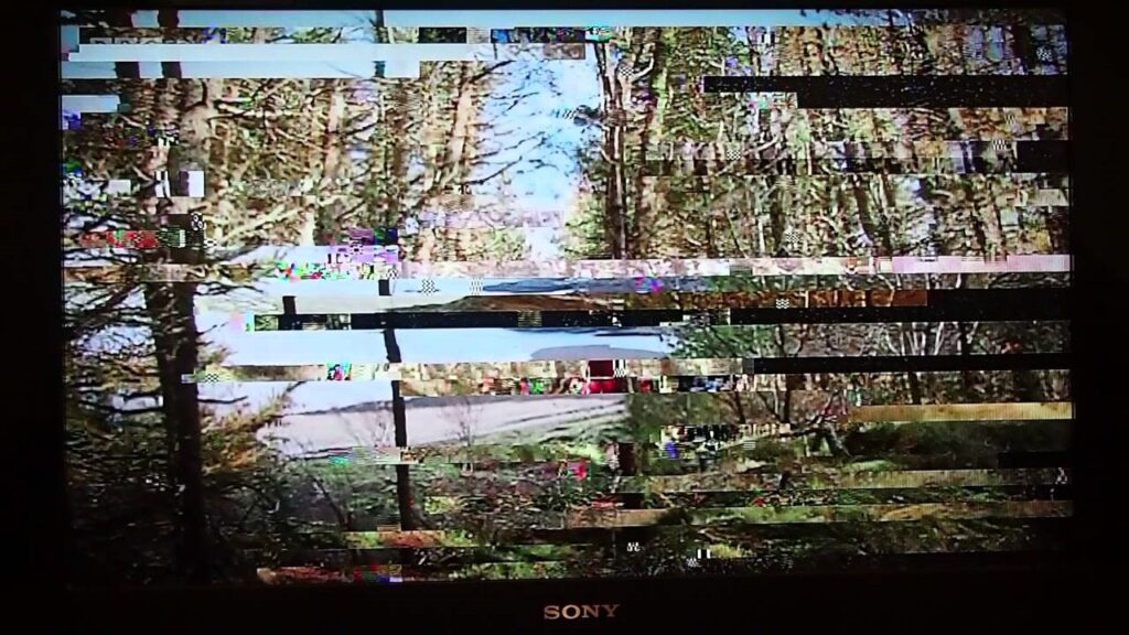

Digital TV Signal Breakup
If you’re experiencing pixelization in your video, breakups in your audio, or failed recordings on a channel that is showing as full strength, try these OTA signal troubleshooting steps on the Tablo Knowledge Base. If the video is still problematic, place a ticket with Tablo Support. By logging in to your Tablo remotely, Tablo Support can access more granular signal quality details and run a longer and more thorough channel scan to help determine why your OTA signal is not clear.
