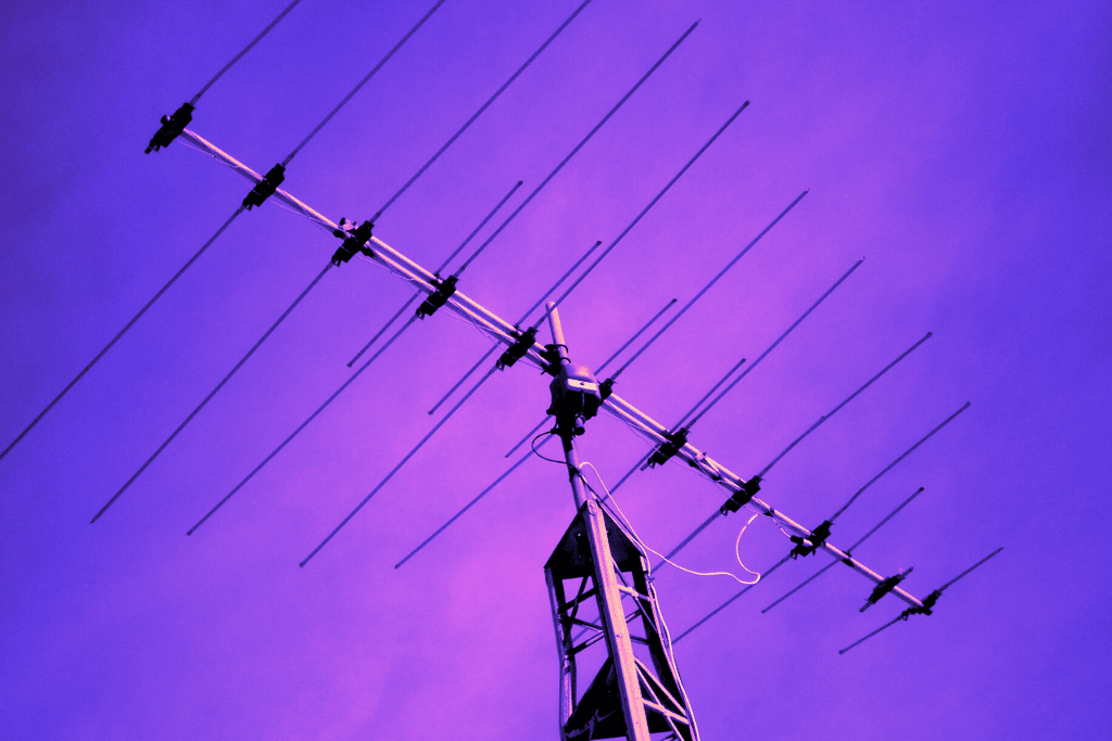

ABC in Philadelphia is an anomaly because it still broadcasts on the low VHF spectrum and therefore requires an antenna design much different than the average commercial TV antenna.
Outdoor antennas capable of picking up low VHF channels have very long rods (aka dipoles) while indoor models generally use more traditional ‘rabbit ear’ antenna rods that can be extended to receive VHF stations.

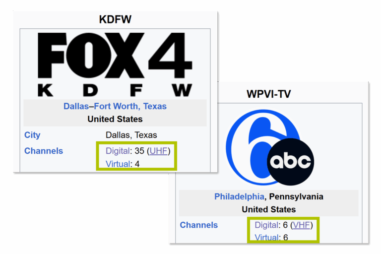

All over-the-air channels have both a ‘virtual’ channel number – what you see as a viewer – and a separate ‘digital’ channel number used for transmitting. These numbers aren’t always the same, so unfortunately, it’s not safe to assume all channels below 14 are VHF.
For example, viewers in Dallas tune in to channel 4.1 to watch FOX affiliate KFDW. But its digital or transmit channel is 35, which means it’s on the UHF spectrum and a specialized TV antenna isn’t required.
In the case of WPVI in Philadelphia, its digital channel number and virtual channel number are both 6.1, meaning it is broadcast on the low VHF spectrum.
It’s easy to confirm which frequency your local channel is using if you suspect VHF is the cause of your reception issues. Simply search the station’s call letters on Wikipedia. The sidebar section will show the station’s virtual and digital channel numbers, as well as whether it’s broadcast on the VHF or UHF spectrum.
