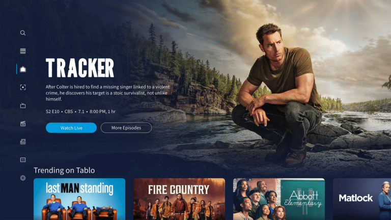

Tablo Home Screen - Top showing popular sitcom
Home
Enjoy quick access to what’s airing live, your recent recordings and tailored recommendations.
TIP – Add channels to your favorites list from the live TV grid so programming suggestions from those channels will appear on home.

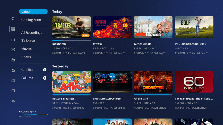

Library screen in the Tablo app
Library
See and manage your DVR schedules and recordings. This screen will also allow you to keep tabs on available recording space.
TIP – Set series recordings (ALL or ALL NEW) for your favorite shows and Tablo will record airings automatically until you tell it to stop.
